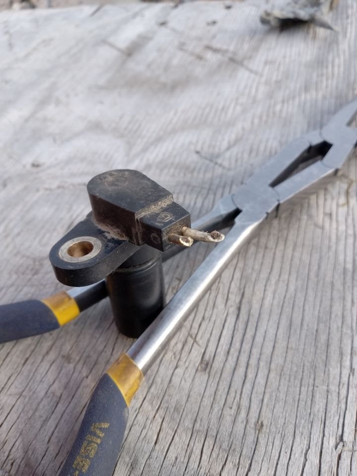

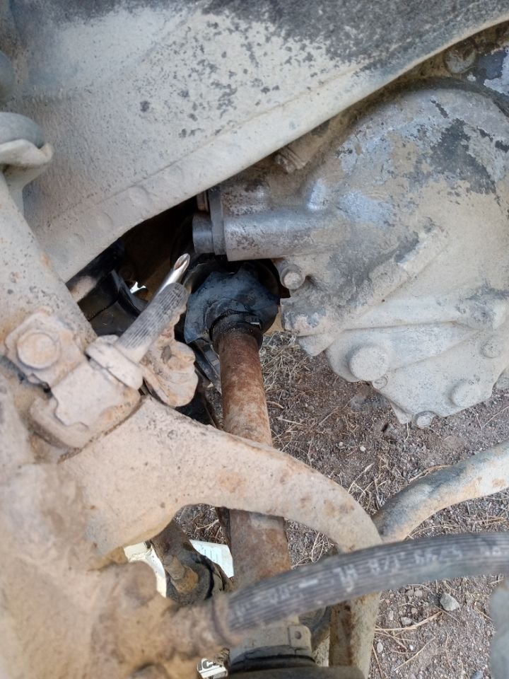

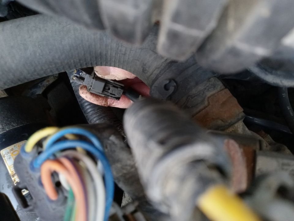

I found out where the other end of this chewed connector is.
It is supposed to be connected to this sensor being pointed to with a phillips screwdriver. Its in the right side fender well, on the end of the automatic transmission.
It is supposed to be connected to this sensor being pointed to with a phillips screwdriver. It's in the right side fender well, on the end of the automatic transmission.
Here is the sensor pulled out. Will someone please tell me what this is called, and what information it sends?
Thank you!
Old Dec 24, 2024 | 08:21 AM
Posts: 16,331
That is a sensor detecting rotation. I don't have a shop manual in front of me, but could be the main shaft or countershaft speed sensor. If you go to a site like hondapartsnow.com, you can identify which sensor it is.

The three wires for the VSS were cracked and shorting out on each other about five inches frm the sensor. I did not want to pull the engine harness out to repair them, and could not reach the bad areas with my strippers. I ended up running three new wires from where they came from, in front of the left side strut tower. Both the Coolant Temp Sensor and the Intake Air Sensor had about 5 volts on both of their wires, when one wire of each was supposed to be an ECU sensor ground. I snipped the bad wire on each of them, and ran a new ECU sensor ground wire to the connector by intercepting a good sensor ground and running a replacement wire for each.
For the Speed sensor with the chewed off wires shown in a picture above, I soldered new wires to the nubs and got that working again. I have a new sensor ordered to replace that one since I don't want to rely on my shady emergency soldering technique, using a propane torch and melting some of the plastic on the sensor and barbequing some of the wire insulation.
