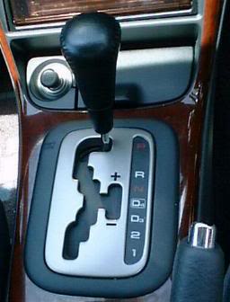

4th gen preludes did NOT come with f20b not even the jdm ones. f22a1, f20b (SOHC) and h22a are the only engines that came in the 4th gen ludes. It came in the JDM siR accord.
Also 3200rpms sounds about right. You have a short geared trans now. How many times does the trans shift? It should shift 3 times and that’s it (4 speed auto)
You have a h22 auto trans. The f20b is a obd2 engine your cb7 is a obd1 set up. So the wiring harness will be a must. Also your f20b could be a S-Matic Transmission. Did you swap over the auto shifter too? looks like this...

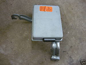

That's prob why your shift points are off. I would imagine your cruise control might now work b/c there is a computer for it. Since your cb7 is obd1 and the f20b is obd2. You might need the f20b computer.
This is what the CC CPU looks like...
It's located under the dash on the driver side left of the steering wheel
