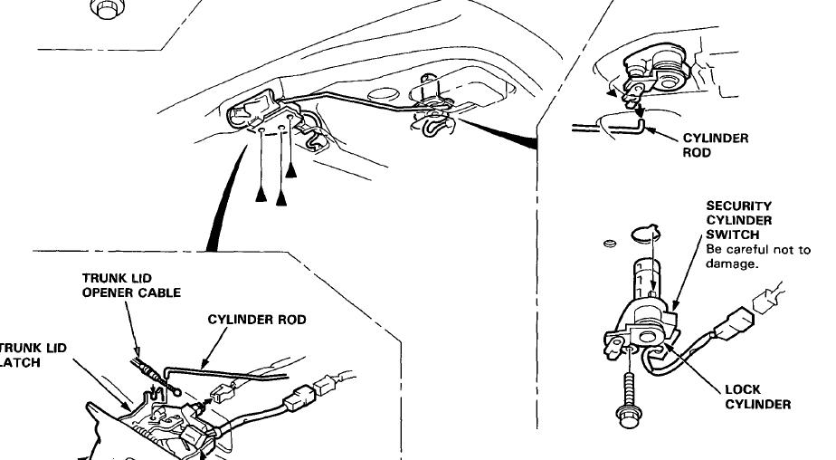

Hi - I have 2 issues:
1) Had key made from glove box lock, but it will NOT start the car
2) Need help removing the trunk lock to see if key can be made from there.
Any explanation for #1 or help with #2???

Does the key that they made work any of the other locks on the car....door, trunk (I know you list that one but need to ask)?
oh, and welcome to HAF.
Old Dec 2, 2012 | 07:19 AM
Sorry and to answer your question....I think there is a plastic cover you have to remove to "see" the lock in the trunk. Then there is a plastic clip holding the rod to the cyl, be very careful when removing that. Then there should be one 10mm head bolt.

Hi - I went and tried all spots:
Trunk - no
Lock on floor/drivers side (?) - no
Doors - yes
Thanks again for helping.

Forgot to mention - The diagram is tough to follow, as I can't enlarge, etc. Can you send me a copy to my email?
I took off the one bolt, but it seems "stuck" and won't move, almost as if I have to pull the whole back off to get closer to it? I'm afraid to put too much force on anything since the car is so old.
