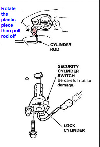

Have you got the cylinder out yet?
Rotate the plastic clip off the rod before trying to pull the rod out.
After the bolt (10mm socket) is removed, you may have to slightly twist the cylinder to remove it.

I did send you an e-mail with the pic so between that and what Redbull posted you should be good to go on getting the trunk lock out. If not let us know and if you can post a pic of where you are stuck that will help.

Okay all you wonderful helpers/mods - I got the trunk lock cylinder out, it was just a little "stuck", but I got it out and managed to remove the rod without breaking anything so far!
I will bring the glove box cylinder AND the trunk cylinder in together - if they were the same, the key should open the trunk too, but it doesn't. I'm praying the code is found (I see something on there, is this a code? B3M2)
