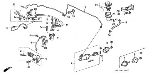

It is likely an assembly fixture that needs to be fully tightened to seal the hole. See attached picture from parts guide.
Attached Thumbnails 93 Accord New Clutch Master Cylinder has leak in strange place-13sm401_b2320.jpg

Great diagram thanks, do you happen to have the key that shows what everything is called? It'd be handy to keep on hand.
