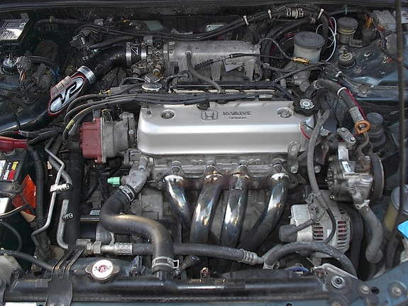

There are some clips that hold the spark plug wires to help prevent them from rubbing and shorting. I attached a picture. Not critical for getting the car to start.
