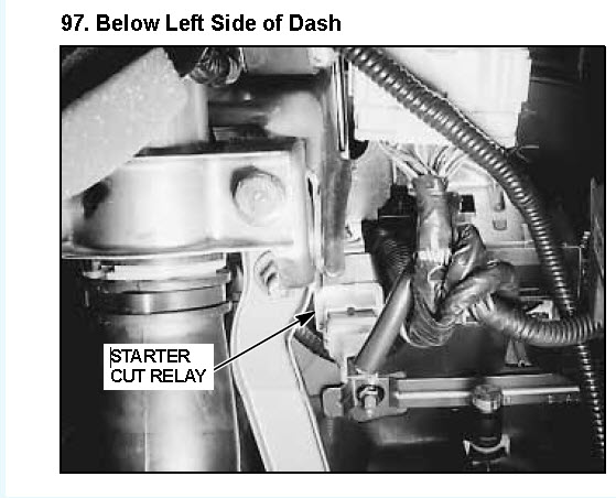

The clicking you were hearing may be the starter cut relay clicking.
Attached Thumbnails 94 accord did stock swap clicks when battery hook up-5th-gen-accord-starter-cut-relay.jpg

Maybe but it would still turn over?
