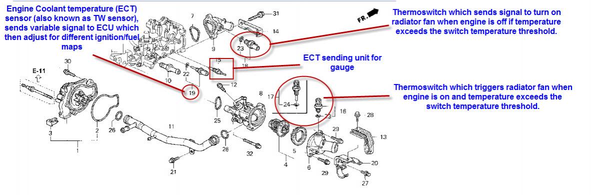

Well, the thing is, the ECT sender for the gauge is not the switch to trigger the fans. You may have more than one problem.
As Jim said, you have 4 sensors on the car.
You want to jump the one the thermostat housing that has the green plug, then start the car. Both fans should run.
If not, turn off the car, unplug the electrical connector to the fan that is not working, start the car again. Measure voltage across the connector going to the passenger side fan. If you have 12V, then the fan motor is bad.

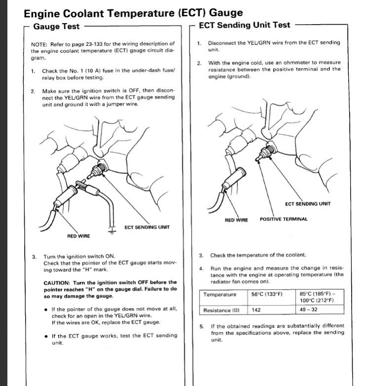

The sending unit has the one wire connector, and it only sends a signal to the gauge that you see in your dash. It sounds like something is either up with the gauge or the wiring. If you tough that red wire to ground and turn the key to the II position, the temperature gauge should start to go up. Turn off the key before the gauge gets past the red, as you can damage the needle.
The ECT only sends the coolant temperature to the ECU, so the ECU can adjust air/fuel ratio, idle, etc. The only reason to mess with this is if you got a check engine code for that sensor. The ECT sensor is next to sending unit.
The fourth sensor also has a green plug and is on the front of the engine block. It will turn on both fans when the coolant reaches a set temperature when the engine is turned off.

there's 4 things that look like temperature sensors - make sure you're dealing with the correct ones.
End of the cylinder head, kinda below the distributor there's 2 of em.
Water temperature sensor (for the ecm) has a plastic plug with 2 wires.
Temperature sender (for the dashboard gauge) has 1 wire. Unplug the single-wire and the gauge should go to cold.
Then there's 2 fan switches at the radiator hoses.
Follow the lower radiator hose back to the thermostat housing (below the throttlebody). The 2-wire switch back there is responsible for switching both fans while the engine is on. Unplug that & jumper the wire with a paperclip. Turn the key on (engine doesn't actually need to be running) - both fans should run.
The last one (at the upper radiator hose nozzle in the head) is responsible for switching one fan after you turn off the engine. Immediately after turning off the key, jumper that wire with a paperclip and one fan should run. There's a timer to turn it off after something like 20 minutes, even if you leave the jumper connected.

There is probably something up with the wiring or the gauge itself. The connection to the gauge cluster could be loose or have a bad connection.
Either way, you will probably have to remove the cluster to test that wire sending the signal to the temperature guage. Do you have a volt meter?
