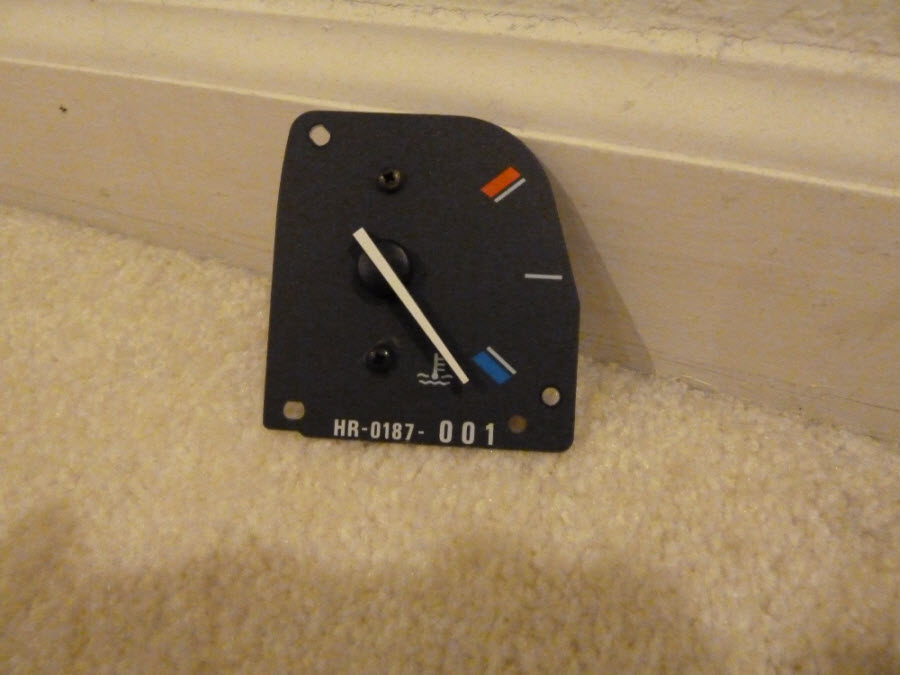

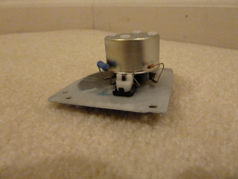

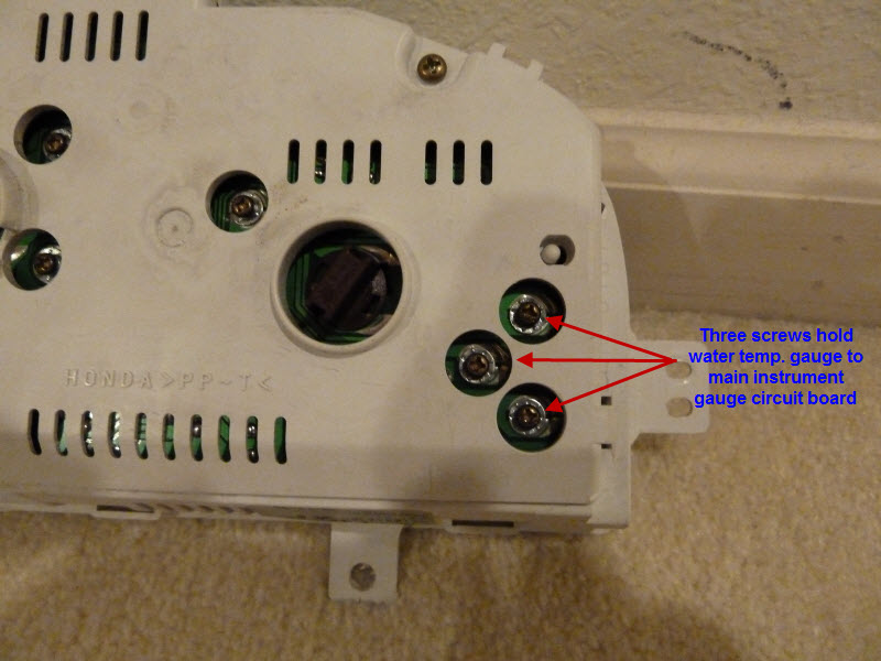

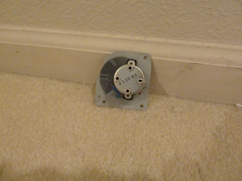

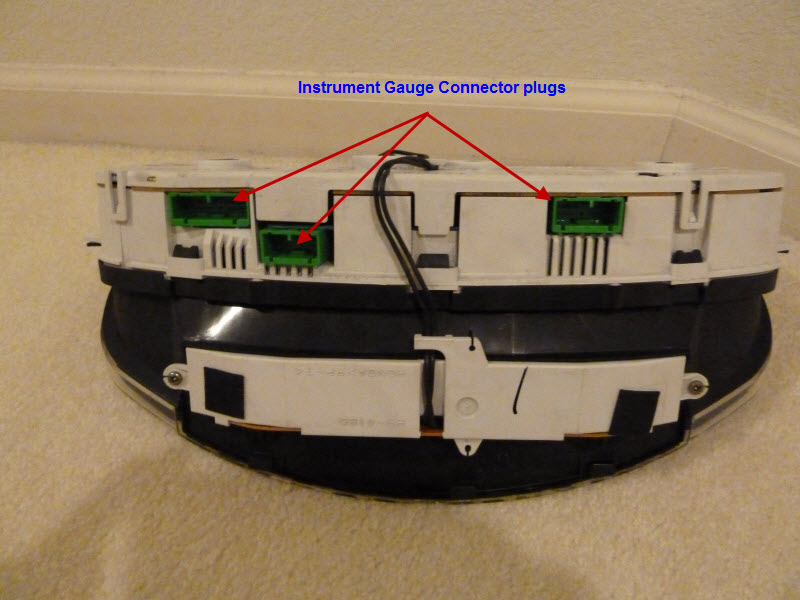

well my mind is set that one of the sensors has gone bad because i dont even turn the car on yet when my dash says that it is on normal temperature(half way up) and that shouldnt be happening at all for what i have heard.correct?
I am thinking this problem is with the gauge itself. It should be showing cold when the ignition is not turned to ON.
All the instrument gauges are part of a larger instrument panel circuit board and separately removable and replaceable. For example, the speedometer is part of the larger mother circuit board; but, the speedometer gauge has a smaller daughter board for certain functions of the speedometer. There are three electrical connectors that plug into the instrument panel; but, I don't believe any one of them is solely for the water temperature gauge.
For the water temperature gauge, I don't see an exposed individual daughter board. There also does not appear to be a capacitor which would retain a charge to keep the reading where it was before the ignition was turned off.
In your previous post, you do state that the gauge does move, so the ECT sender unit may be working (not sure if it is working properly though, you would have to measure the resistance of the sender unit as shown here: https://www.hondaaccordforum.com/for...9&d=1295664803)
Here are some pictures of the gauge unit in relation to the instrument gauge panel.
Attached Thumbnails 94 accord overheating :( help!-gauge-front-.jpg   94 accord overheating :( help!-back-instrument-panel.jpg   94 accord overheating :( help!-instrument-gauge-connector-plugs.jpg   94 accord overheating :( help!-gauge-behind-.jpg   94 accord overheating :( help!-gauge-side-.jpg

You might want to try unplugging the Yel/Grn wire from the ECT sender in the engine compartment; but, don't turn on the ignition to see if the gauge drops to cold. If it doesn't, this may be more indication of the individual temp. gauge in the cluster needing to be replaced.
