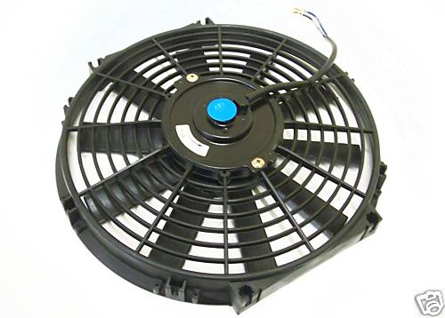

the fan mounts on with universal pins. looks like this Name:  fan-12-universal-1.jpg
Size:  26.5 KB and also it is a 12 blade universal electric fan that i got pretty cheap on ebay. got it for 25 bucks.and the polarity matters? i will make sure it pulls the air into the engine from outside. it is a "push and pull fan" meaning it works both ways i just have to flip the fan around i believe correct? and i will take the dash apart this weekend just to buy time and i should be getting the sending unit sensor in i got that for around $20.so easy fix. overall spent 80 all in total. not too bad...but mostly labor work has to be done i enjoy it so no problem

Looks like bare wires for you to splice into the plug from your old motor. IF it runs backwards, swap the wires. It has to pull the air through towards the engine, in the same direction as the air moves from the motion of driving.
i will make sure of that.i will confirm that th eair flow is in the correct direction,thanks for pointing that out, and also thanks so much for the help!i wnt to thank evry that contributed to my post and i will also keep everyone updates when i do the fix =)

guys!thanks to everyone my engine has not overheated anymore.i had to grab the fan onto the radiator using zip ties.i had to put the small zip ties going through the radiator.and i wires everything up. also the sensor was the fix i needed to replace that sensor and that was the only problem i had. the fan and the sensor were replaced. so thanks to everyone no more overheating!
