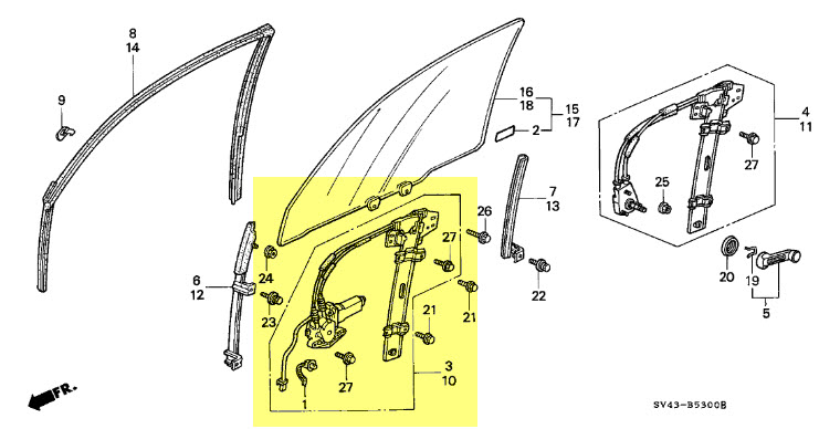

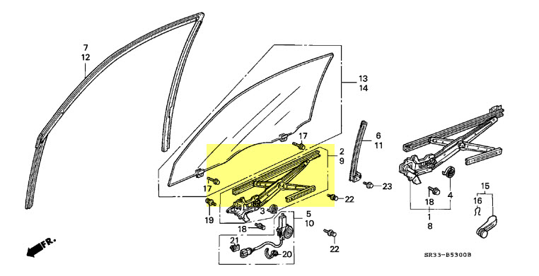

It's not confusing, a power window regulator/motor for a Civic and Accord are not the same design and will not fit; whether it is 2, 3, 4 door, etc.
The attached pictures for a 1994 Civic and Accord.
Accord coupe and sedan use different regulators; but, neither is the same as the Civics.

On the Honda O.E. parts diagrams, all 1994 Civics window regulators do not show any of the same design as the 1994 Accord coupe or sedans.
Even if they are a similar design from a different year Civic, I doubt it will be a direct fit, as the mounting holes for the regulator and motor may not line up.
Additionally, the travel of the window regulator may not go up and down as far as on the Accord.
