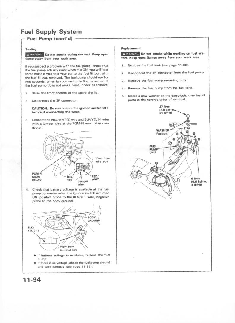

- The Fuel Pump Test - there was no voltage - so i proceeded to the main relay troubleshoot

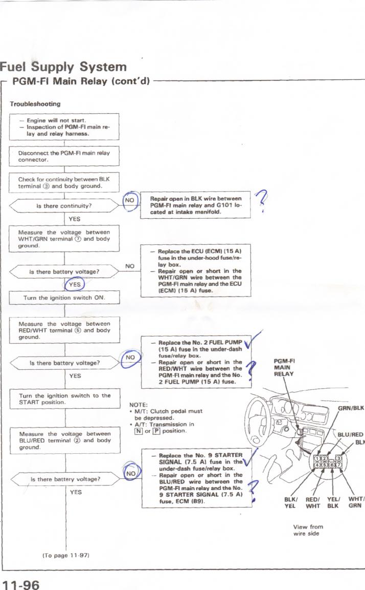

- The Main Relay Trouble Shoot failed the first question with an unknown way to preceed on the recommendation, passed the 2nd question, failed the 3rd question with a good fuse and unknown on the recommendation, and failed the 4th question with a good fuse and unknown on the recommendation

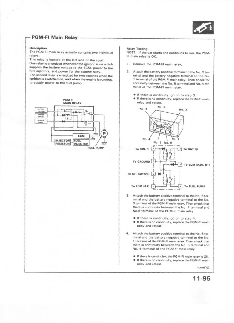

- The Main Relay Test - failed #2
The first test that failed is for continuity to ground on pin three. The resolution is to repair that connection from the relay to ground. G101 is the label for the ground location. It is on page 23-15 in that shop manual that you posted pictures from.

I just want to make sure that you did the continuity test properly. Using your volt meter, either use the resistance reading or continuity reading on it. The ohms from pin 3 to a good ground point should be zero or the continuity test on my meter will beep if the circuit is continuous.

Did you first do the checks to the main relay itself, on the right side of page 11-95?
The checks on page 11-96 are actually checking the car's wiring, not the actual relay. You did those checks with the relay unplugged, & you're measuring into the wiring harness (not the relay), right?
Forgot to mention, use the meter on a low ohms scale (x1 or x10) or a low range if it's digital. If you use auto range you may get false readings. A good ground connection will show a 0 or less that 1 ohm reading, since you're seeing the resistance of the wire. But for that length of wire, from the dash to the intake manifold you should see 0.
PAHonda - i checked out page 23-15 and say what you were talking about - so, you're saying i need to make sure i have a good ground on the G101?? I also am not a pro at electronics so i could have had it on the wrong setting - i ended up using the 200dcv setting.
Jim Blake - i checked the main relay, but not until the very last (after i took it back out) i listed them in the order i tested them above. Yes, i had the relay unplugged and was checking the wiring harness.
draser - you mentioned the manifold...what is the wiring between the manifold and the fuel pump? i didnt think they were linked by wiring. Again - i could have had it on the wrong setting...unsure.
