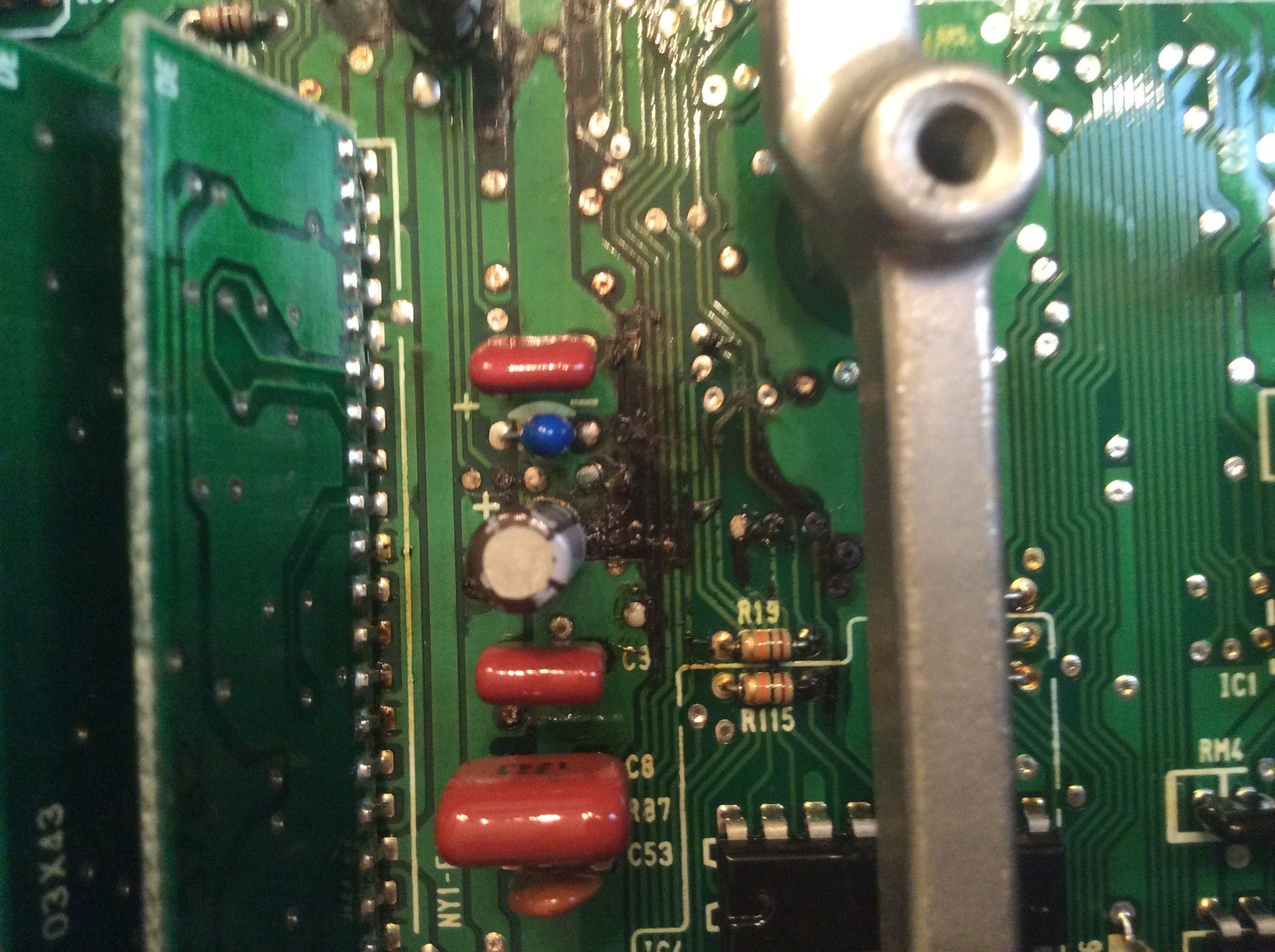

UPDATE: First of all I would like to thank all the replies to this post.
My cel light was not working properly because someone didn't want it to,
Someone scratched the trace on the circuit board so the cel light would not light, then they ran a jumper wire from oil light to cel light so if the oil light was on so was the cel light.
Good news is my ECM is OK, with all the stuff found fixed I now have a working CEL light.
And I have codes Code 9 and 22
I just have to track them down to see whats the issue.
I just can not believe the lengths someone went to just to hide the fact the CEL light was on.

Wow. I would have never guessed that someone went to those lengths to hide a CEL. I'm glad you found the problem. Hopefully you can now resolve the 2 issues.
One code is for a sensor in the distributor.
The other code is with the vtec oil pressure switch.
Both problems can be from the sensor, the wiring, or the ECU. Just make sure to test before you replace parts.
