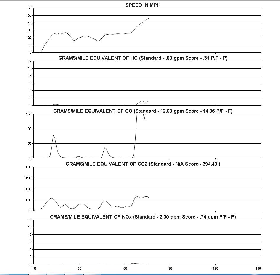

Old Jul 10, 2013 | 04:13 PM
ebeighe's Avatar
Joined: Jul 2013
Posts: 7
Most likely oil in plug wells is not related to emissions failure. ...good luck
thanks. So I haven't gone through the retest yet; I put in the plugs and new O2 sensor, and it seems to me the car runs very well.
BUT now i have a bad feeling that that stuff i did isn't going to help, because...
I just discovered that the detailed graphical test results are available, thanks to the wonders of the internet!
Sorry about the non-standard link (numerical ip) but i promise it's not malware, that's the way AZ MVD does it for some reason.
AZ Drive Trace (test results from failing 7/5/2013 test; image of results is inserted, below)
In any event; what the graphs show is everything seems really good for the first 60 seconds of the test, then when the speed hits like 30mph (and heading up to, say 40mph) --- it's not clear to me what gear it's in --- anyway; the CO goes completely haywire, pegging at 150 (the test limit average must be below 12). Ug. It seems to me this must indicate something -- any ideas?
Edit: here's a picture of the graph (in case the link above doesn't work):
Old Jul 10, 2013 | 06:10 PM
High CO occurs only in a rich condition (not enough air for amount of fuel). This might be caused by badly restricted air filter, or too much fuel; leaking injector, leaking fuel pressure regulator, or lazy O2 sensor.
High CO seems to occur under acceleration; too much fuel? check fuel pressure regulator by pulling vacuum reference line and sniffing for fuel smell. Any fuel smell would indicate ruptured diaphragm.

Old Jul 11, 2013 | 02:54 PM
ebeighe's Avatar
Joined: Jul 2013
Posts: 7
... lazy O2 sensor.
Passed. Passed with flying colors. I suppose this is classic "lazy O2 sensor" behavior?
Below is a link to the graphical result (i LOVE the data. I can't believe all this data has been sitting there all these years and I never knew about it!)... though for some reason the graphs end at 30 seconds and ~ only 30mph. I was in the car with the guy and it did go longer/faster than that, so i'm glad it passed but a little miffed i didn't get all my data.
For the curious / interested: We use the IM147 test in Arizona. I'm a little surprised i can't find the test protocol (they also refer to it as the "drive trace" -- the technician drives the car on rollers at very specific speeds and have to cause very specific gear changes)...
AZ Drive Trace My passing test 7/11/2013
Here, is an example of what a passing test normally would look like, it lasts longer and continues to higher speeds (a friend's car):
AZ Drive Trace passing test of a friend's car
Edit: apparently the test-rig computer is programmed such that if the car is doing really well that it's going to pass the test in any event; so it terminates the test early.
