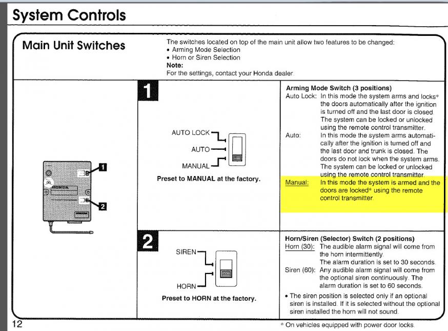

I don't believe 1994 Accord came with factory installed alarms. There was the dealer installed option. However, it came with remote transmitters.
The reset/disarm/valet switch button was normally located on the lower dash cover. It is not a "flip-type" switch, that is why I was asking if it was an aftermarket alarm.
For the 1994 Accord, the dealer installed security control unit was normally located under the driver's seat. (See attached pic.) -- However, for later year Accords, it was located behind the lower dash cover, where the reset/disarm switch was.
The dealer installed Honda alarm, arming mode can be switched to Manual mode, so it doesn't automatically arm.

Have you looked under the driver's seat to determine if this is a Honda alarm system? If it is, one option is, to switch the alarm mode to "Manual" as shown in my post above.
