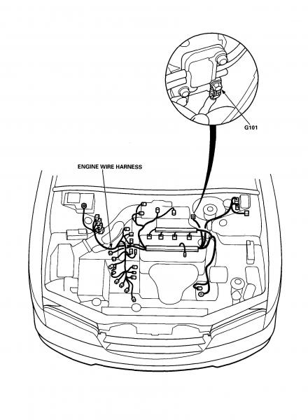

Before you consider replacing the ECU, please disconnect the ground on the driver's side of the upper intake manifold (see pic for g101 location below). Clean the bolt and eyelet with a wire brush or sandpaper, then reattach.
Reset the ECU by pulling the 7.5 amp backup/radio fuse for a minute. Turn the key to the II position, but do not start the car. After the CEL does the bulb check (turns on initially for about two seconds), does the CEL turn back on? If yes, please check your engine codes and tell us what you find.
Attached Thumbnails 94 Honda Accord EX 2.2L VTEC no start HELP-pahonda-5547-albums-pics-2243-picture-g101-6236.jpg

I did pull that ground wire and their was no corrosion or tarnish. I'm trying to get this car working again for my little brother's first car so any more help would be appreciated.
