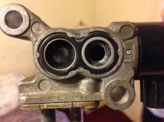

Hey PAhonda all wiring to the valve in good shape but boy is it dirty I took picks of it and I can't seem to figure out how to upload them to show you guys, what cleaner so you guys use my dads fresh out of carb cleaner and the stores on my neck of the woods are closing or closed. As for his scanner is a snap on tools scanner and he's not near me to ask him what code it gave. While I been under the hood I took the plugs and wires out and they were brand spanking new with a new distributor

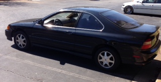

Default A few pics of my accord and a dirty IAC Valve
heres a few pics of the car and that IAC that looks like it needs a serious cleaning... and PAhonda have a question for you, another mechanic touched this car (not my dad or myself) and he noticed how low it idled and adjusted the screw on the throttle and I read where you posted about setting the base Idle because what he did also may have confused the computer so when I clean this IAC and reinstall and have to reset the ecu, how to I adjust it back to a base setting after this guy adjusting what he thought was a low idle issue? I guess I'm asking where is a good starting point to set this from?
