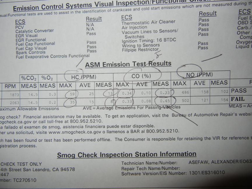

Hey Forum, my 94 F22B Wagon failed smog. So I changed the oil, plugs, air filter, and added seafoam to gas and crankcase. Any more advice before I pay the smog man again? Here's the 5-gas readout:94 Wagon Failed Cal. Smog!-2015-01-18-15.12.56.jpg

Inspect the distributor cap and rotor for signs of wear.
Old Jan 21, 2015 | 09:04 AM
Excessive CO is caused by lack of oxygen (air) to burn fuel completely. Check air filter and air intake for possible blockages. If good, then a new O2 sensor should be considered.
