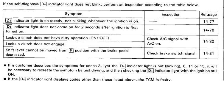

Ok and a reach, the throttle control cable is properly adjusted?
EDIT: Found this as well. Codes or symptoms of 3, 6, 11 with no codes -all to do with lock up or should I say lack of....
3=TP sensor
6=A/T position switch
11= Coil wire
Above is high level descriptions, the manual has more detail
Attached Thumbnails 95 accord ex no lock up after rebuild-5th-gen-lock-up.jpg
