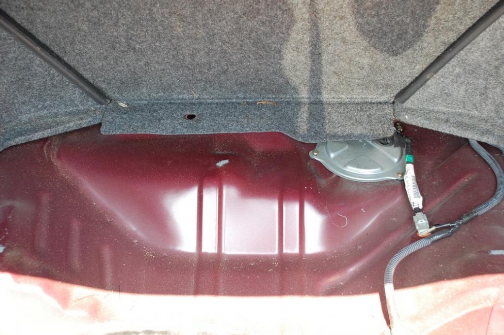

I have a 95 Accord EX 4dr and have not found any specifics on how to replace the fuel sending unit (seems like some have indicated that the access to the sending unit is under the back seat..not sure if I really want to attempt that). Anyway, hoping for more specifcs on location, ease of replacement and should I purchase official part or OEM for my 95 Accord?

It is in the trunk.

I was able resolve my wacky fuel gauge issue by replacing the fuel sending unit. It was a fairly simple task and took about 30 minutes. On my 95 Accord EX – 2.2L access to the fuel sending unit is located in the trunk on the right hand side toward the back of the trunk. Once located, I removed the cover panel which was held by 3 philips screws. After removing the cover panel you will see the top of the fuel sending unit, simply remove the wiring connection and the 5 small bolts. The sending unit then pulls right out of the fuel tank and simply place the new one in. My fuel gauge is now showing the fuel accurately.
