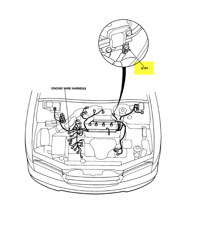

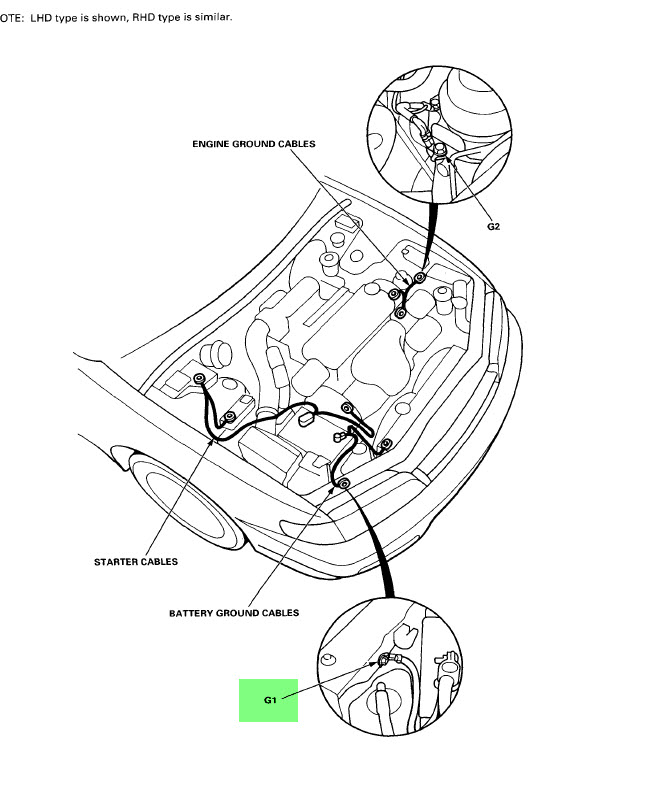

It may be another ground issue now or even a fuse. Check ground G1 and G101, also check fuse no. 1 (10A) in the under dash fuse box.
Attached Thumbnails 95 EX Accord won't start after grounding issues fixed.-g1.jpg   95 EX Accord won't start after grounding issues fixed.-g101.jpg
Thanks redbull-1, I was losing the hope on this, problem is not solved yet; maybe I forgot to mention but the car used to start up correctly before even whit the messed up wiring. I'll check the grounding you mention just in case.
The car cranks and has spark, I haven't played around the timing belt so that is discarded as well, the only thing I notice is the fuel pump is not making the typical humming sound to load the fuel rail, meaning somewhere the fuel pump is getting the current interrupted, I'll also check the main relay to check it isn't the reason for these problems.
