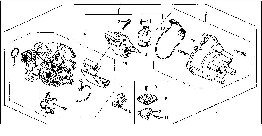

Old Apr 1, 2012 | 10:02 AM
I thought the o-ring came with the cap from the dealer?
See #2 in pic, or the o-ring is #10.
Then you are there, might as well get the rotor.
I will say the last dist cap I got for my 95 from carquest came with the o-ring???? Guess I got lucky.

Old Apr 2, 2012 | 06:10 PM
The dist rotor is #3 in the pic. Normal tune up consists of dist cap, dist rotor, spark plugs and inspection of the spark plug wires.
Highly suggest going to the dealer, or buy from a dealer online, and getting the cap (again comes with the o-ring) and the rotor.
