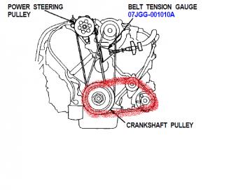

On a 95 V6 engine, there are three belts. The alternator, power steering, and the a/c compressor each have their own belt.
I attached a picture. If that belt that has the spray paint in red is missing, then the only problem will be that the a/c doesn't work.
