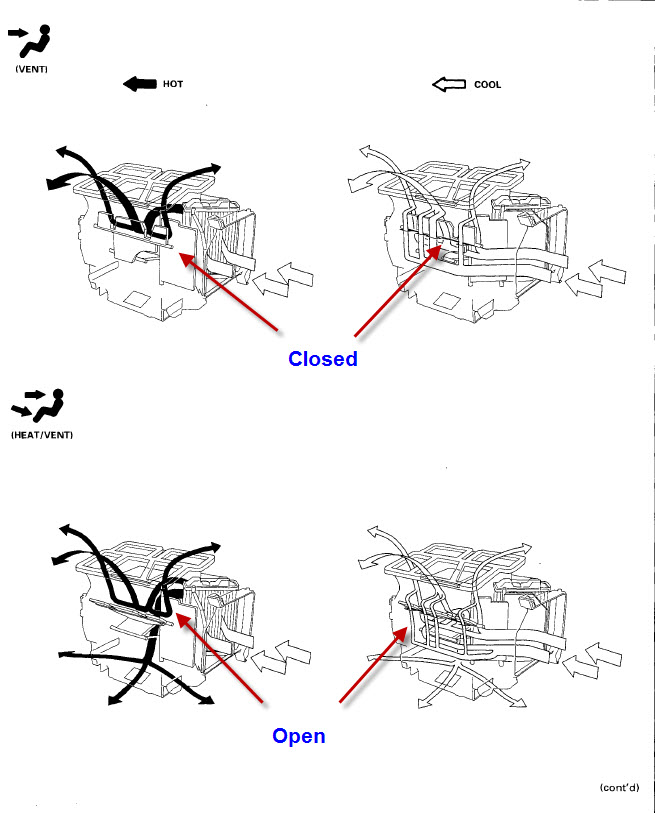

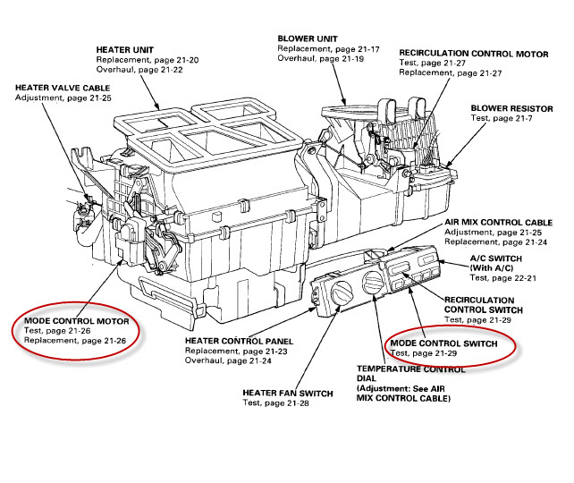

Yea the center vents won't blow any air just the outer pass/driver vents are blowing. No matter what the controls are. I've only heard all vents not blowing at certain speeds.
Old May 26, 2011 | 10:44 AM
1. The attached pic. shows the high and low sides are the ac.
2. No air blowing from the center vent may be due to the mode control motor, mode control switch, or the center door flap on the heater unit stuck.
Go download the service manual to see how to test the motor and switch.
