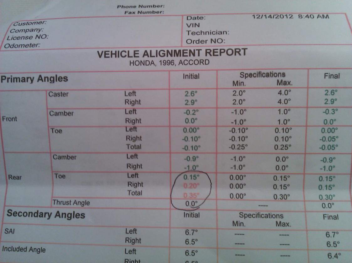

My 96 accord dx was pulling to the right very badly (to go straight I have to turn the wheel to about 11 o clock) and needed new tires cause the front ones were worn down very badly on the inside rim.
So I took it in got 4 new tires and an alignment, and after all that it's still pulling to the right just like before.
Ive checked to make sure tire pressure was the same on all tires.
Heres the printout showing the alignment report. I would greatly appreciate any help or insight into this.

They barely got the rear within spec. And it is at the max specification from their chart. Who did the alignment?
Has the car had any other work done lately? Has it hit a curb/pothole recently (by you or any other driver)?

They didn't align it right. Your right front toe is -0.05 and left front 0.00. Front toe should both be at 0.00 degrees.
The rear toe should be about 0.08 degrees. They set your rear toe exactly at the max positive.
Whoever aligned your vehicle is an amateur.

http://img16.imageshack.us/img16/6007/captureajf.jpg
^print that out, and tell them if it doesnt match those specs... legal actions will be taken if you get in an accident due to their negligence
