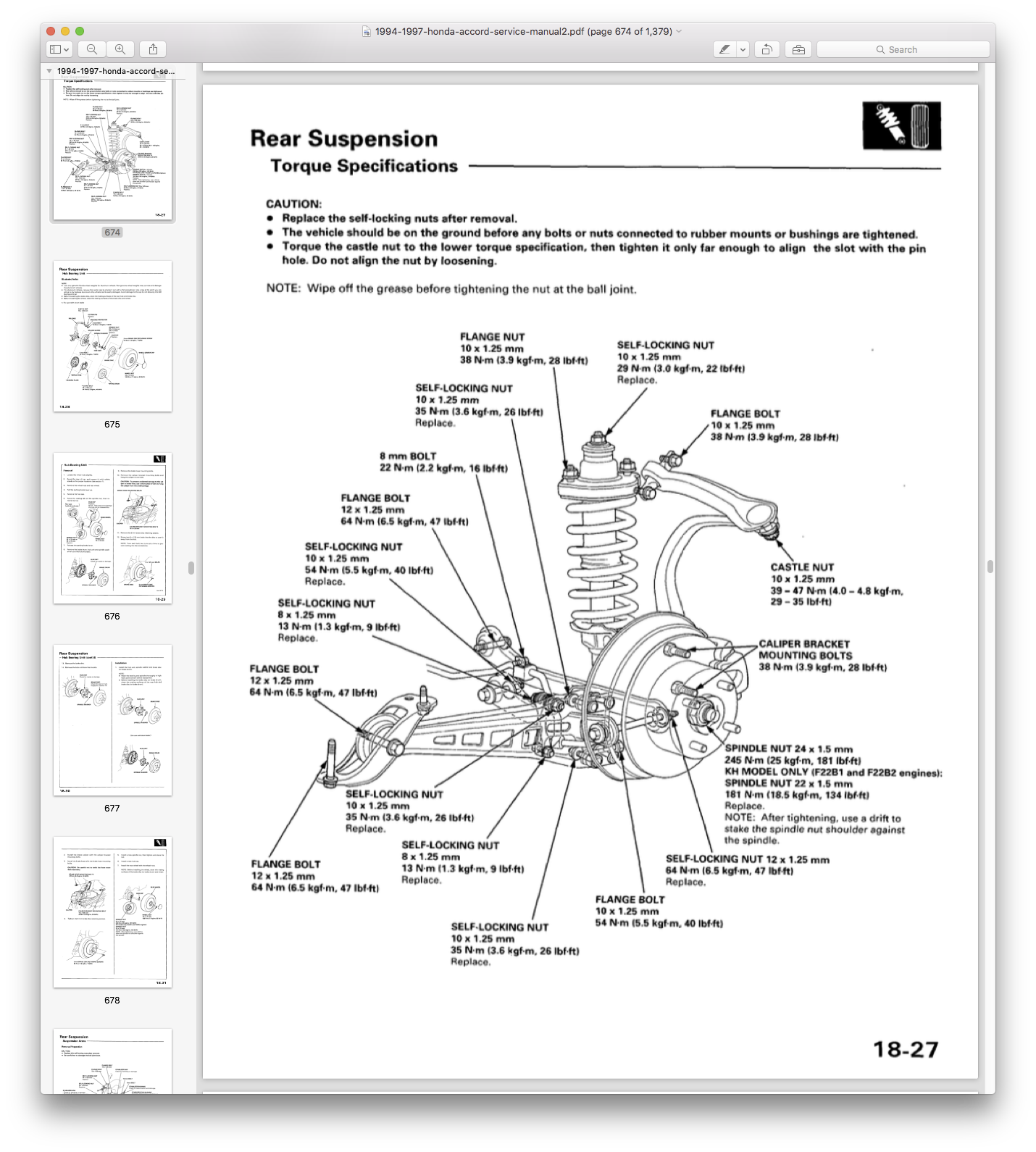

where did you see that? Every reference I've see shows either/or ... e.g.
Attached Thumbnails 96 EX Sedan 4cyl rear axle nut -- 22m or 24mm?-screen-shot-2016-02-16-1.25.08-pm.png

From what I can tell, the KH is for China and South American cars. Unless you're there use the 22 mm spindle nut. I got the info out of a US factory manual. It did not have the KH designation.
