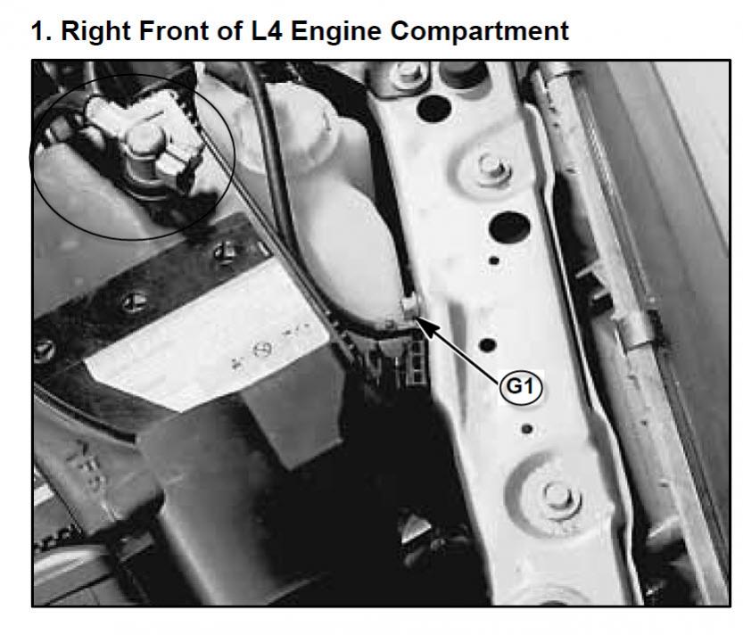

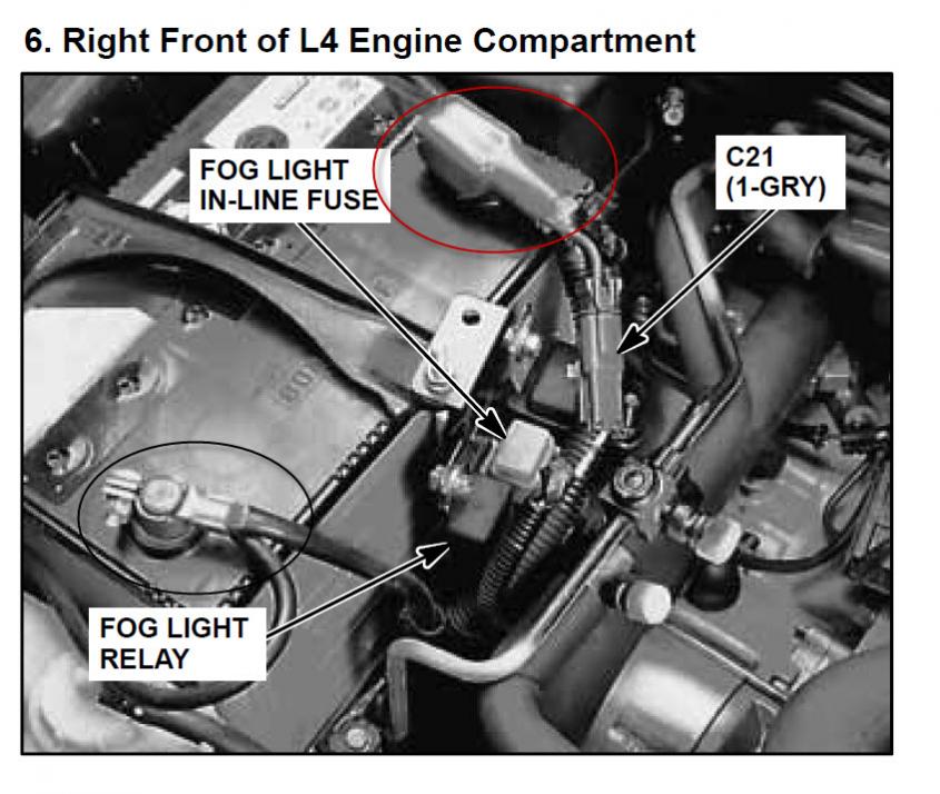

Have you checked the conditions of the battery cables and starter cables?
Check both end of each battery cable for corrosion, frayed wires on cables.
