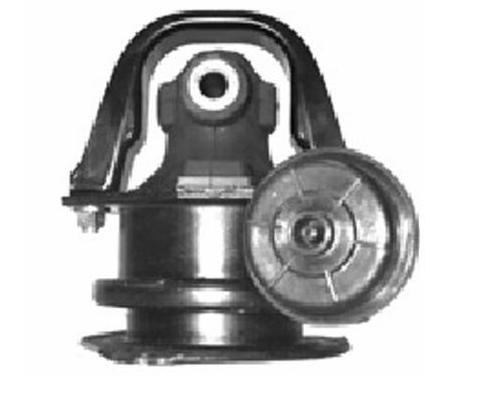

Here is exactly what it looks like.
http://i54.tinypic.com/21mrsef.jpg
Old Oct 23, 2011 | 09:01 AM
Yes, that is a picture of one without the valve...
From the factory (auto trans) the mount has the valve....some will delete it, like yours. replacement mount without this is cheaper than one with it.
If your mount does not have it, as long as the line is capped you will be fine. If it does, it is up to you if you want to hook up the line.
The theory for this is at idle, especailly with ac on, this will help smooth engine vibration in the car.

I looked at the motor mount on the car and there is a bracket where the vacuum port is suppose to go, but this one has none. This mount has one without the vacuum control. I looked up the original part for my car and it appears that it has a vacuum port on it.
So when he replaced it, he got a motor mount without the vacuum solenoid control unit because it was cheaper. So the motor mount helps for better control for idling and reduce vibration as you said for the vacuum type. I know the front motor mount has fluid in it. I had to get that replaced several years ago and it cost $350 just for the part.
