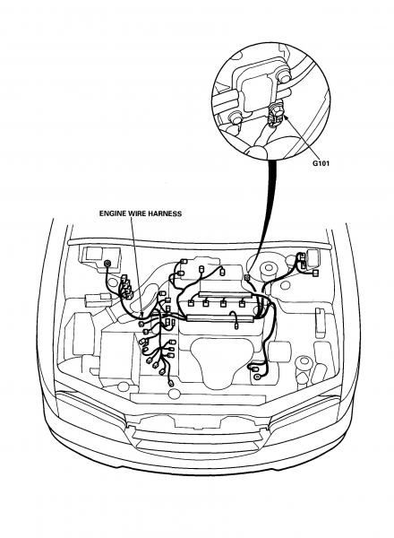

P0705 is not listed as a code in my 97 shop manual. Are you sure about this code? The P0141 wouldn't cause a problem with shifting.
Since you are not getting codes that are part of the 97 PCM (please verify the code), I'd suspect something is wrong with the PCM. There is a ground (G101), that you should find, unbolt, cleanup the bolt and eyelet, then reattach. See Pic below. It is on the opposite end from the throttle body on the upper part of the intake manifold.
Attached Thumbnails 97 accord tranmission"limp mode" p0700 tcu??-pahonda-5547-albums-pics-2243-picture-g101-6236.jpg

I'm not sure I can find theverything ground. Is it directly to the left of the master cylinder? What will taking it off do??

There was only one ground I wanted you to clean, G101. See pic and my description above. Its simple to do and worth a shot.
If cleaning only G101 doesn't help, you are getting a code that is not listed in the shop manual, so a replacement PCM is something to try. Just don't want you to waste money if that isn't the problem.

I really appreciate all your help. I found and cleaned that G101 ground. Still having same issues. I'm not trying to throw money at this either but I'm so angry at this point i. Going to get it fixed out of spite. Do you know anything about trans range sensor, or should I just replace the PCM??
