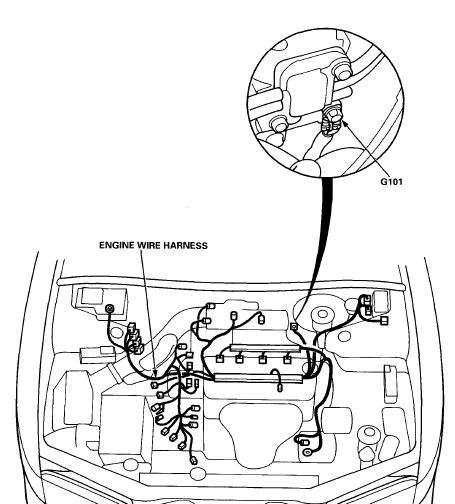

There is a thread on the internet where the guy's car doesn't run well without the scan tool plugged in. In his case, it turned out to be a ground connection. Probably ground location G101 for his car, as the shop didn't tell him specifically, only said near the intake.

So my guy that did the TPS just informs me that he took the intake off to change the TPS. So I will see if there is a missing ground. I'll update you guys later.
Old Jul 25, 2012 | 06:39 PM
Not only missing but if loose or dirty it will cause the same type of thing. So even if it is connected I would remove/clean and then attach.

Sure enough that was the problem. It was there but it was only finger tight. So once I tightened it up it ran great. Thanks everyone!
