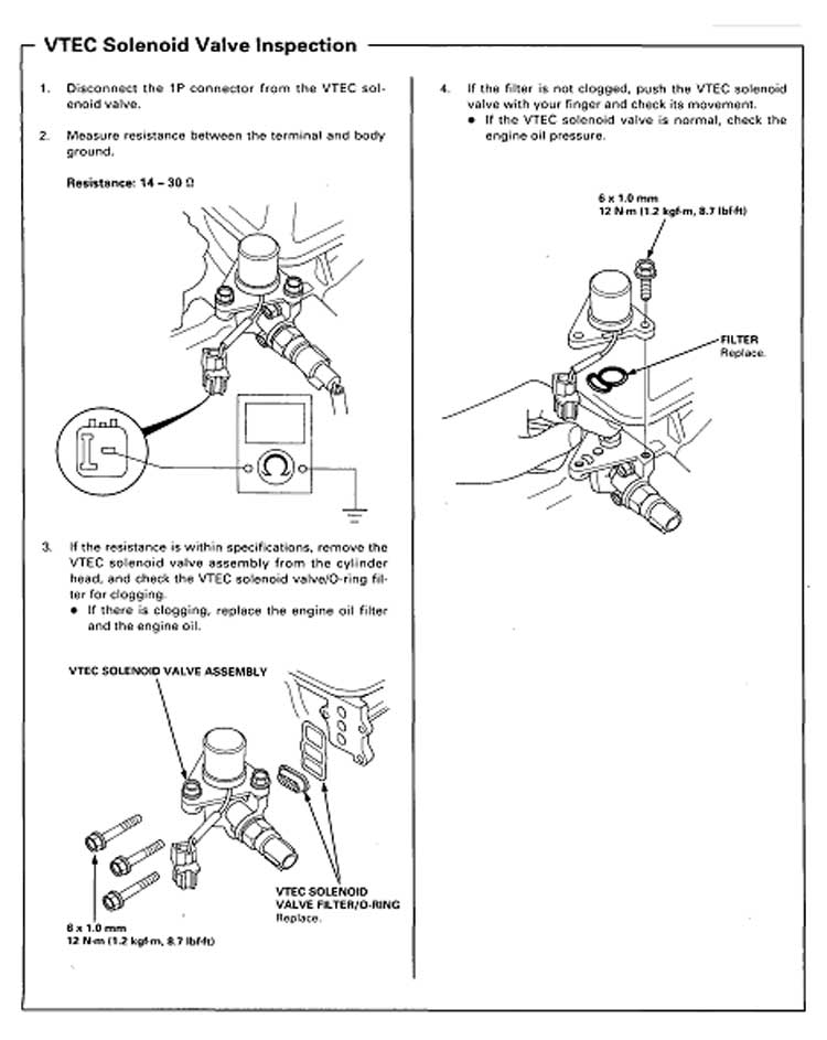

Me, I'd run a piece of wire with an inline fuse from battery + over to the unplugged solenoid and listen for a click. If it clicked, I'd run that same piece of wire from the solenoid through a cracked window into the car. Then I'd run another wire from a 12v source in the car - the cigarette lighter or whatever - get out on the highway then touch the two wires together when the engine was winding up over 4000 RPM. See if I got a kick in the rear.
If it didn't click I'd probably take a trip to the junkyard and get another one before taking the old one off. Clean the screen as long as I'm in there:
