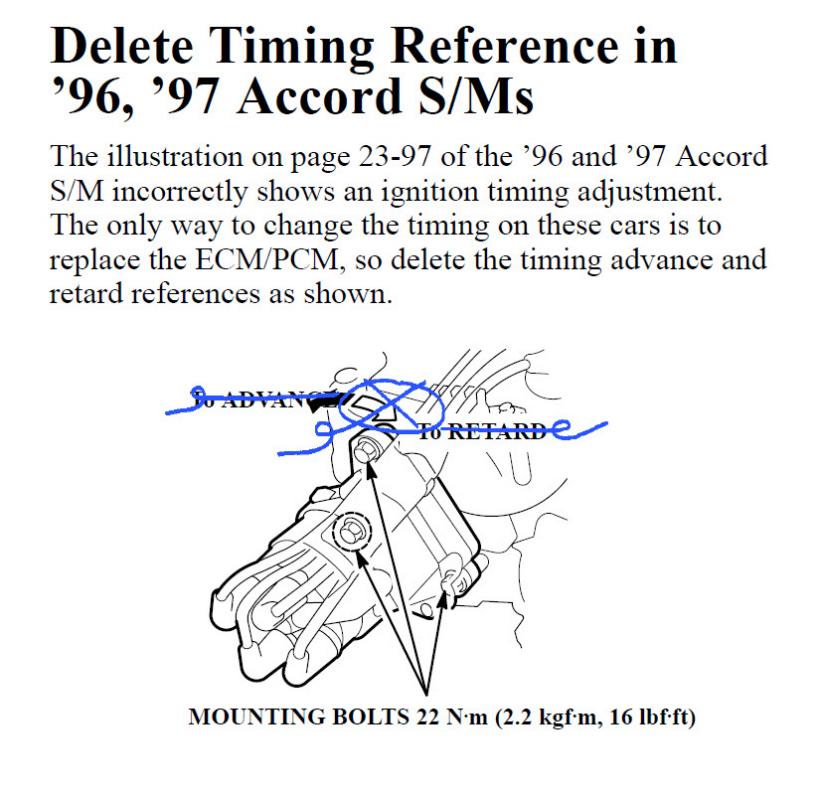

Just for informational purposes; turning the distributor on a stock 96 or 97 Accord won't affect (i.e, advance or retard) ignition timing. See attached pic. from a Honda Service News article excerpt.
Attached Thumbnails 97 Accord won't rev past 5500 rpm-1996-1997-accord-no-ignition-timing-adjustment-distributor.jpg

Never seen that before. Where exactly is that from ?
