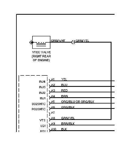

Somewhere in my poor memory I think the VTEC solenoid has a unique circuit configuration.
Most everything on Hondas have continuous battery voltage, and they are switched by the ECM on the ground side of the circuit.
The VTEC solenoid is unusual that it has only one wire. The ECM provedes 5v to turn it on; it is electrically grounded through it's mounting bolts. I think somewhere in the Helm book is a troubleshooting chart that gives that voltage, asking you to back-probe the plug or something. If someone can verify that it is indeed 5v, then the solenoid might not be good after all. Maybe it works at 12v but not at 5v.

Jim - That's an interesting theory. I have only read that the solenoid gets 12v though? If your idea is true, then that would explain everything.
I assumed that the solenoid, being an actuator (vs. a sensor), would receive 12v from the ECU. I've never measured it. When doing my swap and stuck with a dead P0H I contemplated using an RPM switch to activate the solenoid. Didn't because the ECU changes the fuel mapping when VTEC is engaged and I just didn't want to risk it. There are people who use them, though, and run the solenoid with 12v.
Unfortunately the diagnostics in the FSM are all static: resistance checks of the solenoid and wiring. IDK about other manuals.
