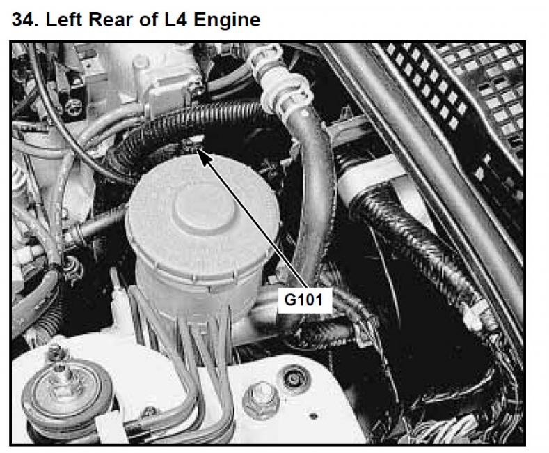

May be a ground wire issue, the scan tool may be supplying the ground.
Check ground G101 connection.
Attached Thumbnails 97 LX tachometer jumping only when scan tool not connected-5th-gen-accord-g101-ground-location.jpg

Beautiful - that was it! Went out, and that bolt was loose. Must have not been snugged down after I took the manifold off last. Thank you.
