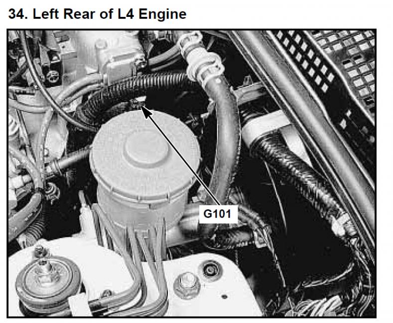

In the under-hood fuse box, check the number 36 (15A) fuse. It protects the radio, cigarette lighter, and the Data Link Connector (DLC); power runs through that fuse to the DLC. The DLC is the OBD-II port.
In addition, check that ground G101 (located on intake manifold) is clean and tight. The OBD-II connector uses that ground.
Attached Thumbnails Honda Accord 96 OBD help the scan tool says it has no power-5th-gen-accord-g101-ground-location.jpg
