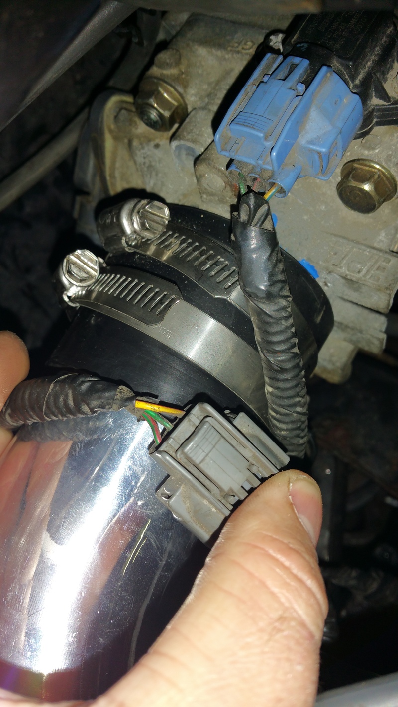

What are the wire colors going to the map sensor? The throttle position sensor?
I will let you know when I get a chance to check them.

Here is a pic of the map sensor and throttle position sensor plugs.

From looking at pics online and the pics I had on my phone before I pulled the motor I am pretty sure I had those plugs backwards. Changed them around and it revved fine.
