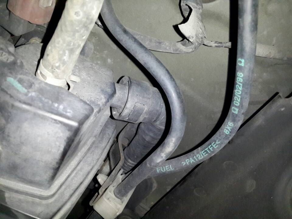

Hello, everyone! I have a 98 honda accord, EX 6 cylinder. The engine light is on, checked the code and found there is an EVAP leaking.
When checked the system under the car, tried to figure out the "leaking", and found these hoses got loose. Would you please help me check what are those hoses, and are they part of the EVAP?
Those two hoses are right next to the Canister, I marked those with red circle.
Really appreciate for your help!

There's 2 different "EVAP" error codes, it would help to know which one.
P1456 EVAP leak - fuel tank system
P1457 EVAP leak - control canister system
Not sure which hoses are in the photo, maybe #24 which I think are associated with the fuel-tank pressure sensor. That pressure sensor is associated with both of those EVAP error codes.

Thanks, JimBlake! I forgot the exactly code, not sure if it was P1456 or P1457. But thanks for the explanation, I will look over to fuel tank system/ pressure sensor. It seems one of the #24 hose is the hose I am looking for, the slim one, but mine has two of them. Thanks for the picture! Will go deeper to the pressure sensor part. Thanks again!

Each one of those 2 codes is saying that part of the EVAP system is not airtight. The system uses the fuel tank pressure sensor to check the airtightness of both parts of the system. I imagine that loose vacuum hoses for the sensor would cause both of those codes together.
For P1456 by far the most common thing is a loose gas cap, so they tell you to check that it's tight & the gasket is good. But P1456 can also be caused by a number of other things including a crack in the tank itself OR LOOSE VACUUM HOSES.
