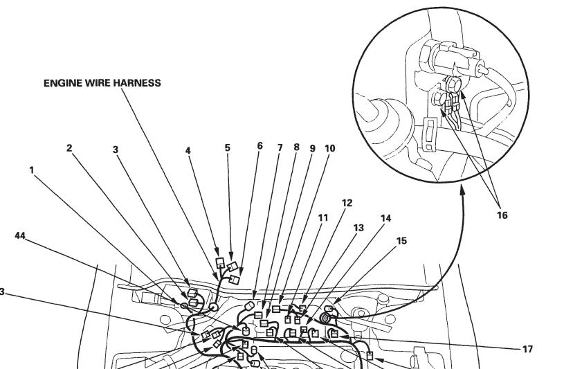

Old Jul 13, 2012 | 07:47 PM
Something like G301 is what Jim is talking about.....see if this helps in finding it
Let us know how it turns out.....it is #20 in the pic
Attached Thumbnails 98 Honda Accord - Left turn signal stays on-6th-gen-g101-loc-4cyl.jpg
