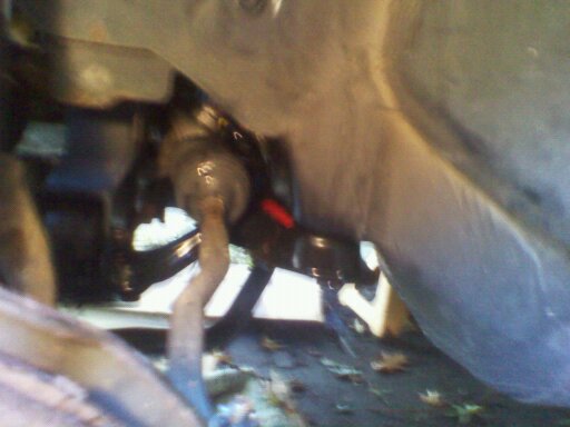

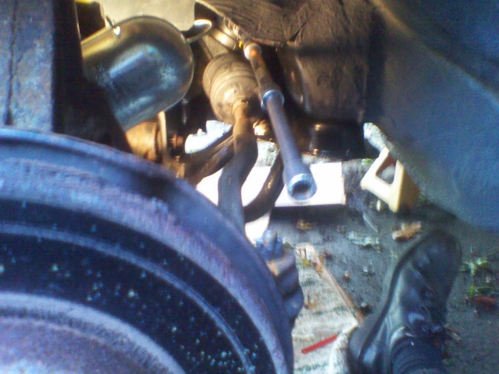

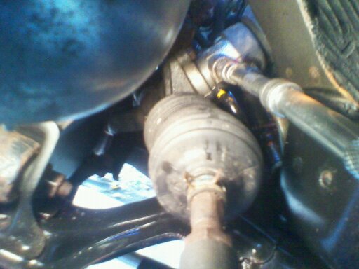

Default 99 Accord Power Steering lines
Finally got back to this job today. Used a saws-all with a 8" metal blade to cut the lines off flush with the line fittings from the bottom. Then used the Craftsman Rounded-Bolt sockets with 1/2" extensions coming out the wheel well to a breaker bar. Pounded the sockets on with a 4 lb. plastic dead blow mallet. Still had to add a jack-handle on the end of the breaker bar, but firm steady pressure finally broke them. Will use the crow's foot line wrench to tighten the lines back up when I install them. Honda discontinued one of the lines, so I will be practicing some fancy tube bending for the "b" pipe on the return line. Sorry about the poor picture quality, but my nephew tore up the drivetrain on his 94 F150 today by putting some 22" wheels on it, so I was kinda in a hurry....
Thanks for all the help.
Patience and Persistence
