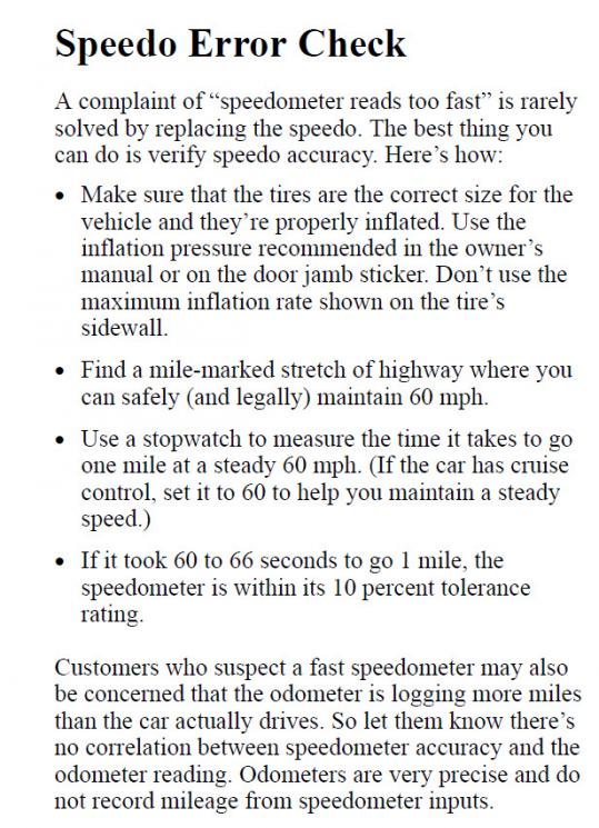

Here's an excerpt from a Honda service news regarding the speedometer and odometer.
The odometer reading on your year Accord should be accurate.
