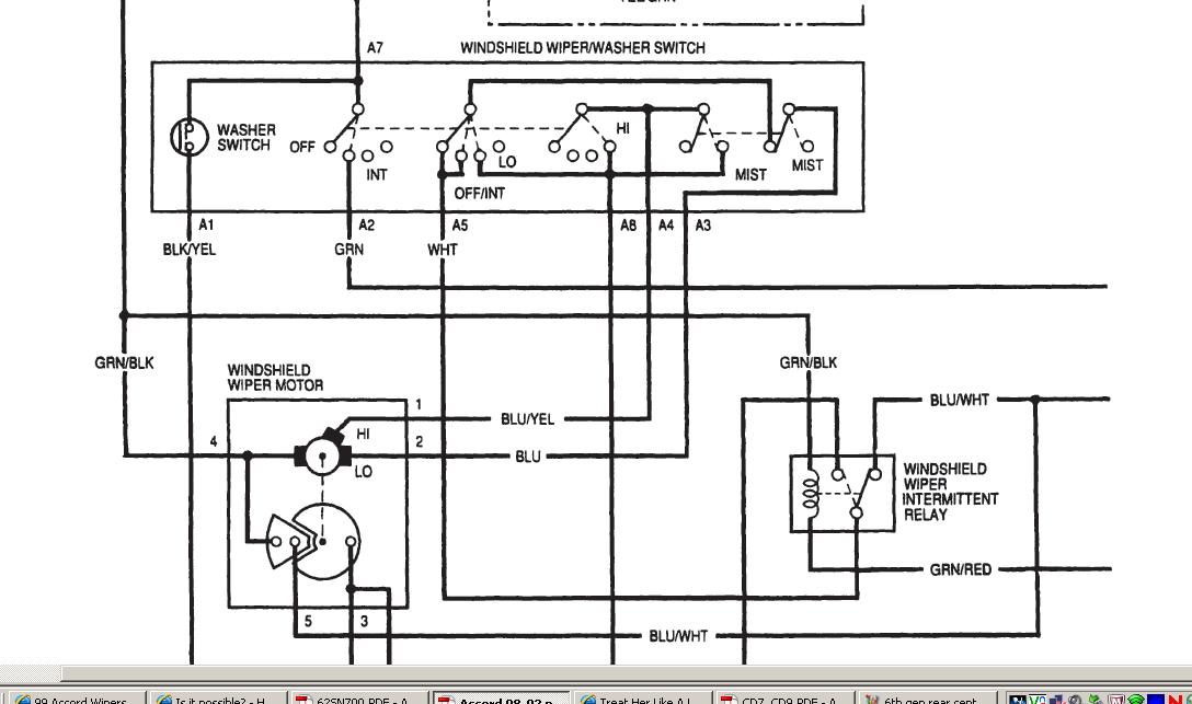

Why would the wiper system work only on 'quick sweep' and not on any other functions? Oh, and washers work, just doesn't wipe while squirting...Just 'low/high/int. not working...Got any suggestions???

It looks like the "quick sweep/mist" function sends the ground to the motor thru a different set of contacts in the wiper switch.....see pic.
Do you have a volt meter and some time to test the wiper switch?
