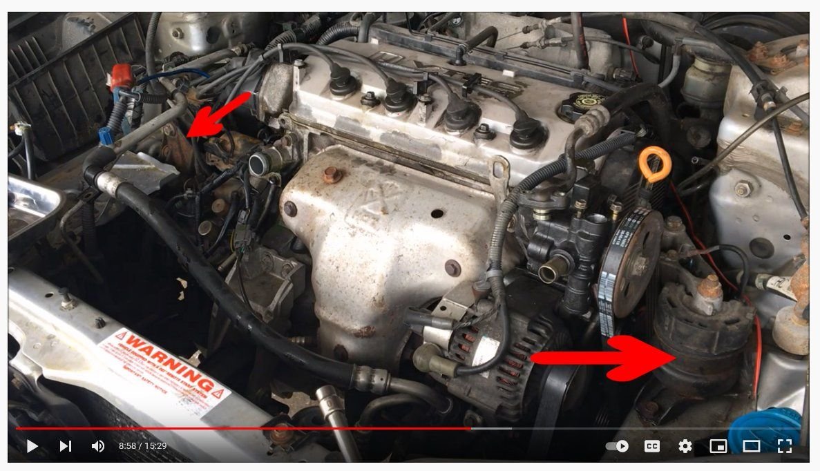

It may or may not be a mount. That kind of noise overlaps... ( transmission mounts vs Transmission issue). Both noises can make a thud or a clank (one time).
The fact that you shift into first and makes the noise says it's either a mount, or it could be first gear transmission issue.
The transmission mount is behind the battery and under the air intake duct. The engine mount is on the driver side.
See the red arrows? Those are what you need to look at.
The reason I suggest looking at the mounts first is that it doesn't cost anything.
Thanks! I'll definitely check that stuff out first then! Much appreciated!
