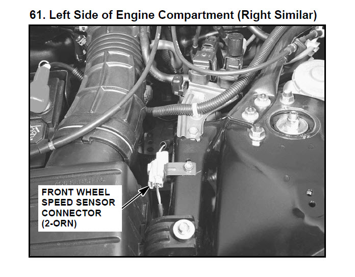

Hi, I have my ABS light coming on, it does go back off sometimes within minutes other times it hours, Had ECM Checked and it comes up as front left Sensor, I tried to take it off today but after getting the bolt out I couldn't get the sensor to budge. Also if I do get it off where is the plug so I can put new one on?

Picture for 4 and 6 cylinder showing me the same identical picture for the left front wheel sensor connector. See attached.

Ok, I ll check today, I figured it was up there, Is it easy to get to the connector? Does it matter if I get a Honda one or a Aftermarket? I also see honda on the website has to Sensors one made in Japan and one made in US.
WHat year car is that pic? My Air Box is on the Pass side.
Old Aug 9, 2013 | 10:29 AM
Picture shows V-6 car with aircleaner on left side. ABS wiring should be the same?

I only see one Honda part number for the left front wheel sensor: 57455-S84-A52. I don't know the quality of the aftermarket wheel sensors.
The pic. doesn't list any specific year, other than applicable to 99-02. Someone only took a picture of the V6; but, included the same pic. when referenced/linked to the sensor for the 4 cylinder.
