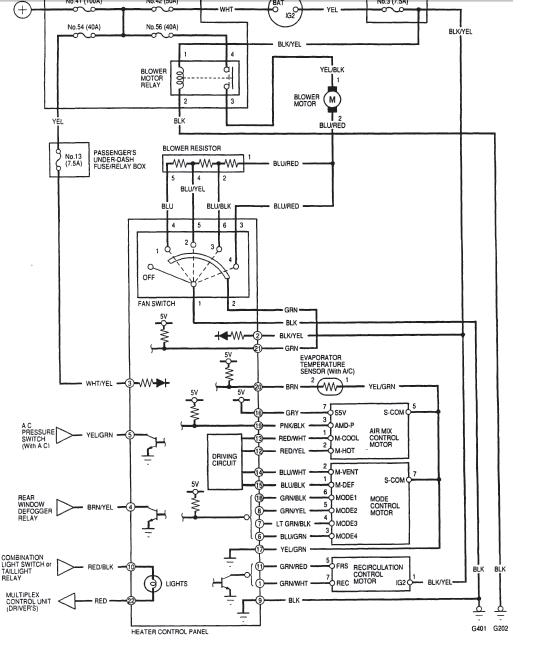

I know this is a bit of an eye chart.......and with the size this might be viewed at, even worse.
Attached Thumbnails AC controls not working, 98-6th-gen-hvac-cir-eye-chart.jpg

Marky C, could it be the evaporator temperature sensor? Looking at the diagram poorman provided, I don't see a resistor in the power supply line to the ac controls, just the sensor.

There sounds like some erroneous info. in this thread. The blower motor resistor shouldn't affect the lighting on the climate control unit.
