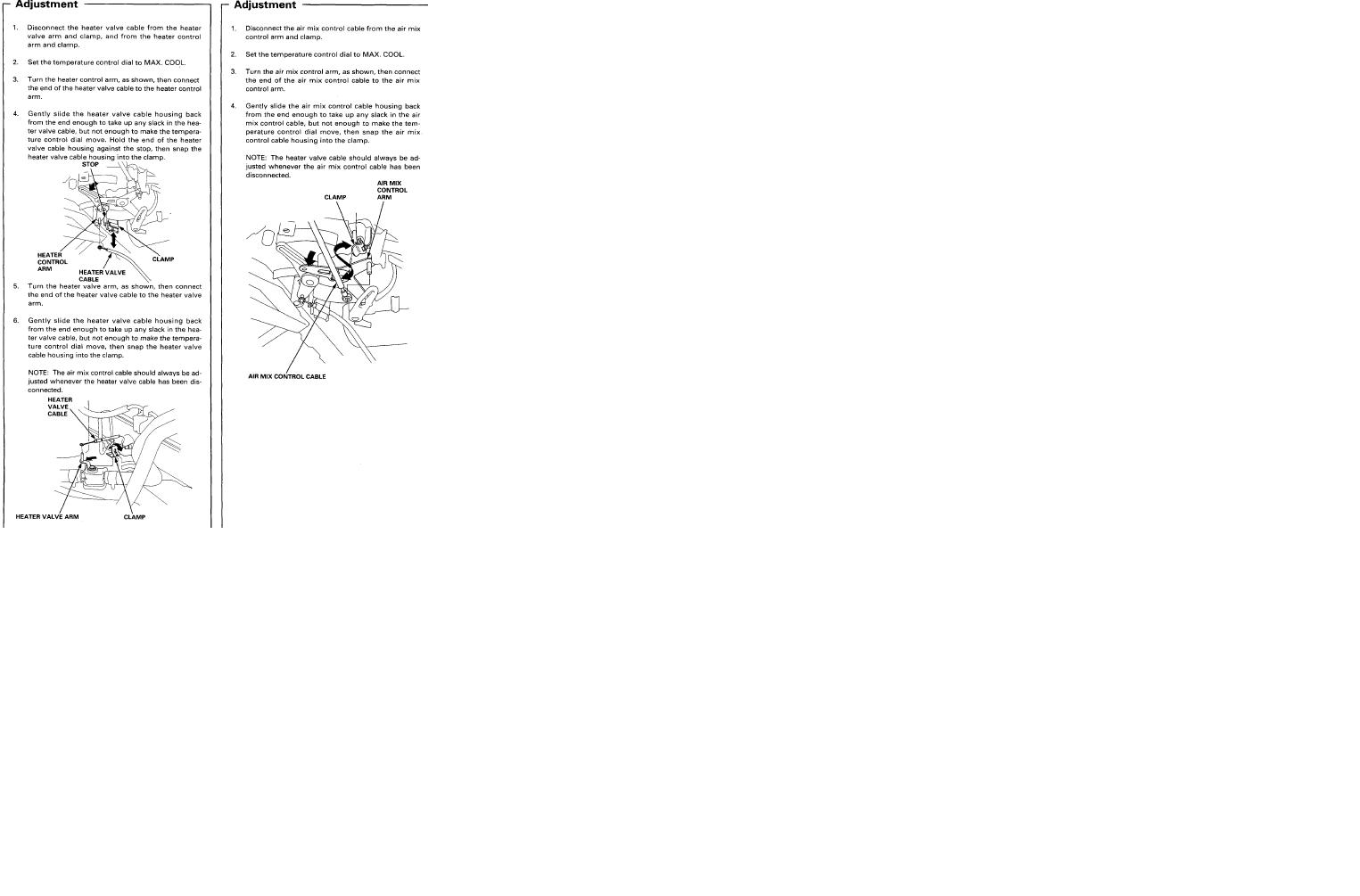

Isn't the procedure two parts? I thought, memory the manual is the proper place, you needed to adjust BOTH cables. The piece under the dash is the connector between the blend door and the actual heater control valve....where is kris l when you need him.....section 21-25 in the manual downloaded from the DIY section has the procedure.

Yes there are two cables as described. Again, page/section 21-25 of the manual has the procedure.
Attached Thumbnails AC temp control knob won't go full cold-cable-adjust.jpg
Thanks poorman. I don't have the manual. The pages you scanned came out too small to really see the picture well, but I can read the text. Is there some way you could email them to me, or post on a photo sharing site?
