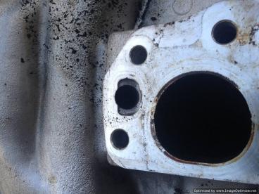

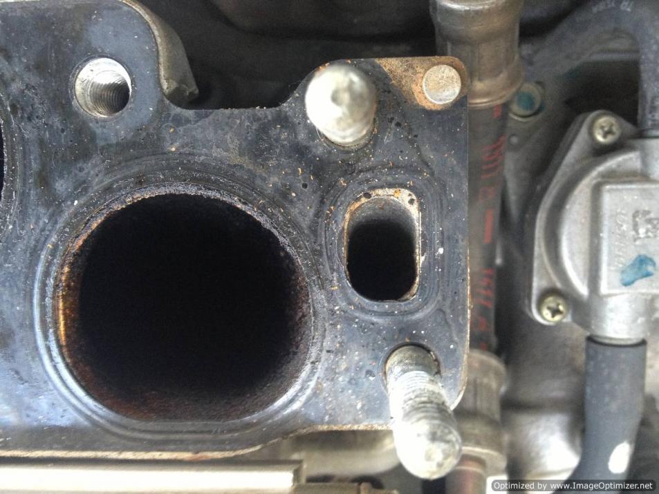

Regularly serviced, well maintained. CEL came on, was throwing P0401. Cleaned the EGR port, reset CEL and it came on 6 miles after driving. Cleaned the EGR port again, reset CEL and it came on 10 miles after driving. Cleaned the EGR port again, reset CEL and it came on 11 miles after driving. TCS light is coming on and off randomly as well, I know this is a sympton. I decided to replace the EGR valve, light still is coming on. I'm attaching photos of my EGR port, they appear to be very clean...they weren't stopped up in the first place really. Can someone please advise on something else to try, this is very aggrevating. Thanks in advance!

I've have that bulletin, I've removed the intake manifold 3 times. I've just got back to the office after having my catalytic converter checked...it's not stopped up. Had the shop reset my CEL with the computer to make sure I'm not getting a ghost code. Light came on 9.5 miles into the drive. Should I be able to run a coat hanger from the EGR valve all the way through the port to the intake manifold? I really appreciate your help on this.
