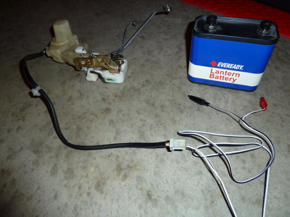

You could take off the door panel and test the door lock motor directly with 12 volt power and ground to see if it is a problem with the actuator.
Just touch one terminal of the actuator connector with positive (+) and the other with negative (-). Switching the wires will reverse the motor, so no need to worry about which will be negative and which positive. Just touch them briefly, as you don't want to burn out the motors.
You could use long speaker wires from the car battery if you don't have a 12 volt source lying around like a lantern battery or something.
This picture is of an actuator removed from the car.
https://www.hondaaccordforum.com/for...g-actuator-jpg

For the testing, you're just removing the door panel and testing the motor at the electrical connector. I only showed my picture as an example of testing the connector terminals with a battery; no need to remove the actuator for the test. Also, that picture shows the whole latch and actuator assembly, if it is only the actuator that is bad, the latch doesn't need to be removed.
