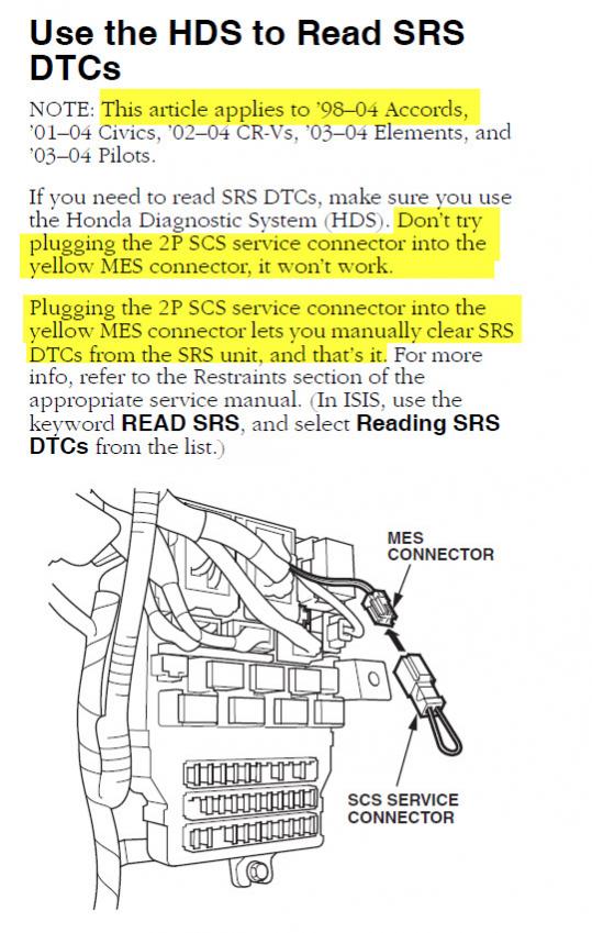

On your car, the SCS line is controlled through the 16P Data Link Connector (DLC). You can not use the yellow MES connector to ground the SCS line (see attached Honda Service News article image). Honda Diagnostic System (HDS) as well as certain scan tools, such as Snap-On have the capability to ground the SCS line through the 16P DLC. Note: The 16P connector is your OBD II connector.
Your AE scan tool may not have the capability to ground the SCS line through the 16P DLC (Data Line Connector). You would have to contact AE scan tool regarding if their tool has such capability.

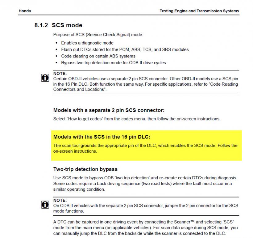

This is an excerpt from Snap-on's scan tool manual describing enabling SCS with their scan tool.

Thanks redbull...& your right on the money. I got the FSM today, & spent this evening going over it. The SCS line can be opened or closed manually by jumpering the DLC or with a scan tool that supports it. Weird thing, is I can read & datalog from the enhanced powertrain, transmission, etc...I just cant actuate commands. I think it must be this ECU, because I can perform systems tests on all other models that I have enhancements for. I've got a Honda Odyssey coming in tomorrow, so I'm keen to plug that in.
Guess I'll have to phone AE & see if they have a fix for this car (:
