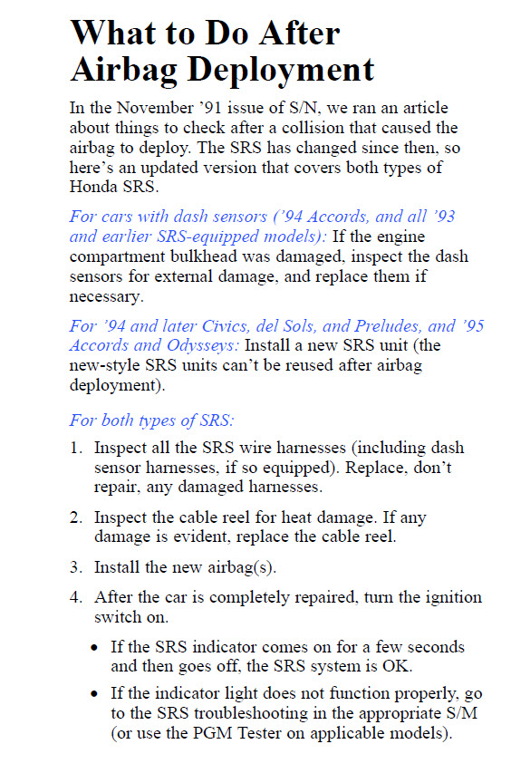

What the mechanic told you was true. 95 and later Accords had different SRS units compared to a 94 Accord (94 Accord SRS units could be re-used after airbag deployment, if no damage to SRS unit).
See this excerpt from Honda Service News issued years ago.
Honda SRS codes on newer Hondas can be read with an OBD-II reader/scanner that have that capability. There are aftermarket reader/scanners with such capability.
