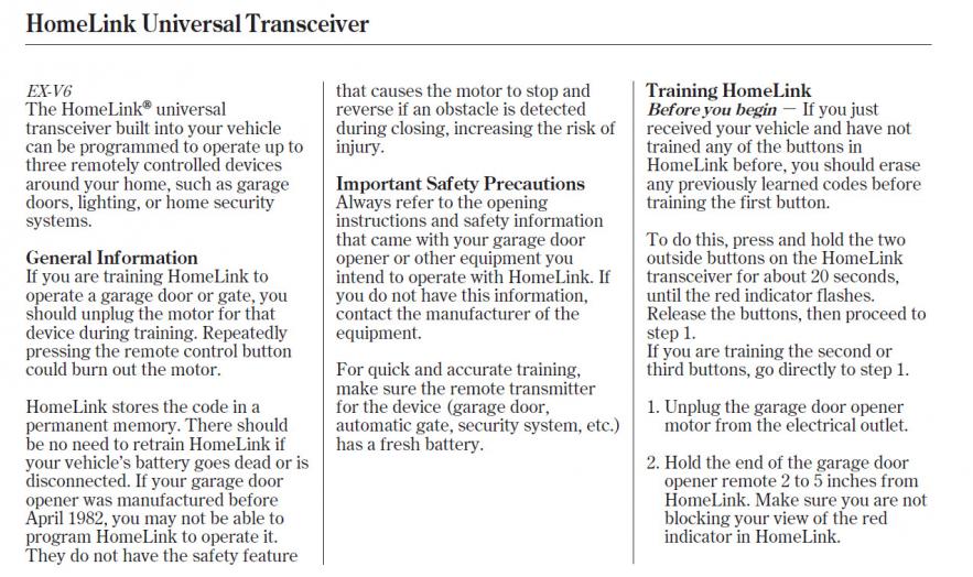

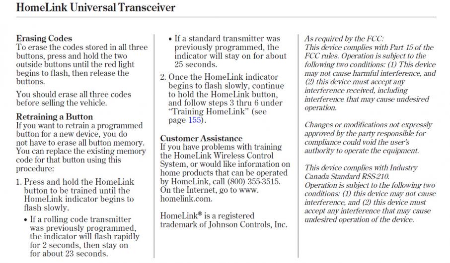

Here's Homelink instructions and for rolling code systems.
The instructions say for the EX-V6. If yours is an aftermarket, then that is a different story.

Thanks for the HomeLink instructions. Roaming codes did the trick.
